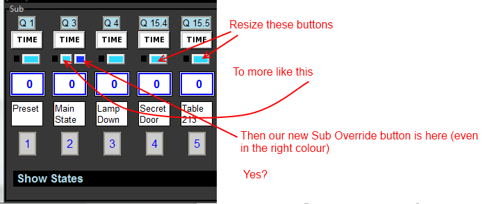

That's why I suggested 'Option' button for Subs, to accept or reject Scene Master override - in *some* cases this might be a good thing...

13 years 8 months ago #5608 by sl1200mk2
Replied by sl1200mk2 on topic 3.0.12_b1
fair enough!
but where to put this option?

13 years 8 months ago #5613 by sl1200mk2
not yet....
Is it true that if you set a submaster in a disable recording state, you probably do not want this sub to be under Scene Master control.
in the other way, if you compose your cue with the submaster, you probably want them to be under the control of the scene master.
your thoughts?
(but basically, I don't like the idea that submasters are part of X1. I think they're parallel to X1 and the scene master should act on X1. my 2cents...)
13 years 8 months ago #5615 by colinc
Replied by colinc on topic 3.0.12_b1
sl1200mk2 wrote: not yet....
your thoughts?
Exactly as you say above
sl1200mk2 wrote: (but basically, I don't like the idea that submasters are part of X1. I think they're parallel to X1 and the scene master should act on X1. my 2cents...)
So normally, yes - but with the option button to allow them to be *in* the scene
(just as you have at the very top of the Subs window, a display button that lets you include or exclude the contents of a sub when recording a cue... (turns orange))
