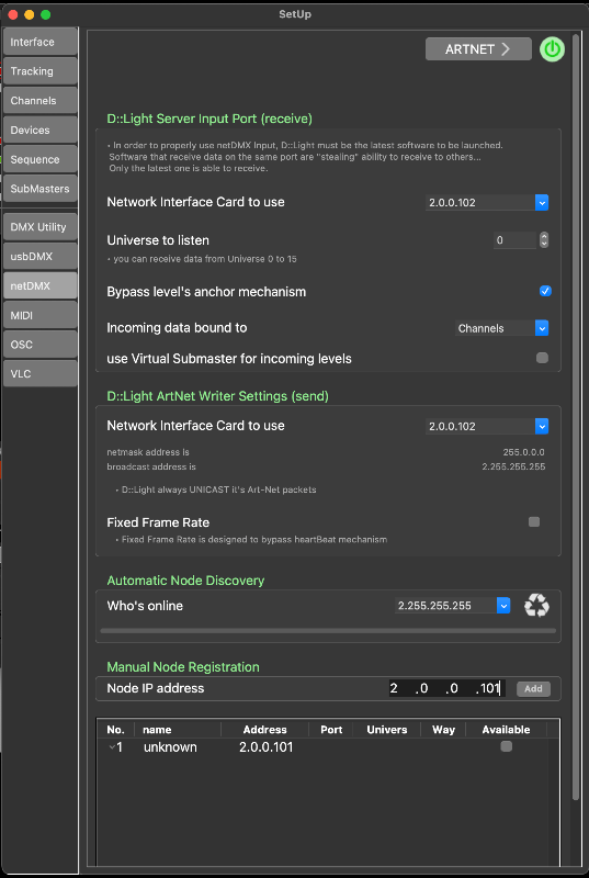

I share two screen captures. The Node shows as connected, Nodes IP is 2.0.0.101. I setup 2.0.0.102 in net preferences and the subtask 255.0.0.0. The IP appears in DLight, but when I check who's online nothing is happening. Same beaheviour with two different ArtNet node hardware

of you know for sure that the IP is 2.0.0.101, just write it in the manual registration and click on 'add'

yes, I also tried the 101, when I write 101 this banner shows up, saying that another web device is using this IP

Not here... at the bottom of the artnet's setup page of DL

yes, I tried that, but nodes are still not showing

In my opinion it's a mistake of the nodes to not respond an artPoll reply to the caller....
Your last picture is OK, click then on available and you should be able to use it.
