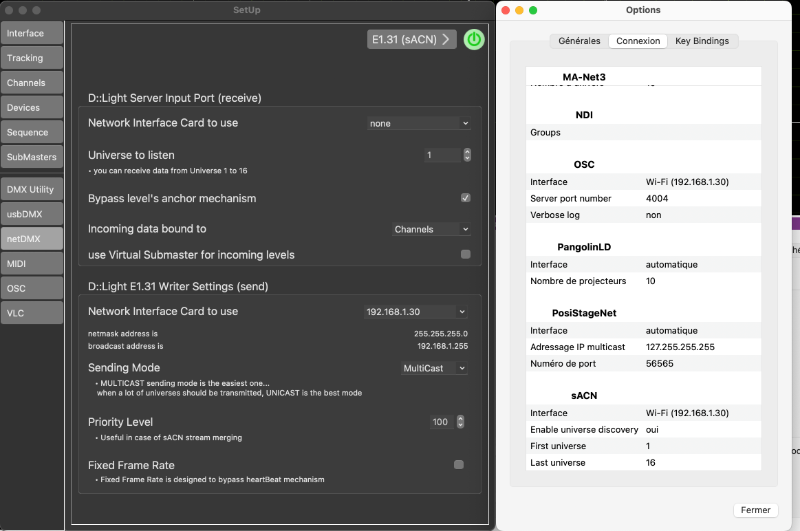

1 year 8 months ago #28195 by Emilepattes
Replied by Emilepattes on topic D::Light >< Capture 2024
Ok je teste en wifi mais toujours pas de résultats:
-> photo
J'essaie en relancant capture, dlight... Je ne sais pas trop ou chercher... Des tips de config réseau? Comment monitorer la sortie dmx de Dlight?
J'ai aussi essayé avec un hotspost wifi de mon portable...
Devrais-je passer plutôt par Artnet ou sAcn?
Si qqun à des piste, je suis preneur ;-)
1 year 8 months ago #28196 by sl1200mk2
Replied by sl1200mk2 on topic D::Light >< Capture 2024
ta config à l'air bien et le sACN est robuste.

1 year 8 months ago #28197 by Emilepattes
Yes, j'ai une licence active et je vois  le signal sAcn moduler dans sacnview
Je vais contacter Capture...

1 year 8 months ago - 1 year 8 months ago #28201 by Emilepattes
Hello, pour travailler en local sur mac voici la solus':
Ajouter avec terminal un routing interne pour rediriger l'sACN :
sudo route -add 239.0.0.0/8 127.0.0.1
Source : Youtube Capture Live:  sACN, Art-net and CITP
Et en bonus du SAV Capture:
Connectivity check list for Capture 2024
1 - Make sure that your console is really sending Art-net or sACN. This is usually easy to tell by the furious flashing of LED's on your network switch.2- Inside Capture, to report connectivity activity, simply click on the "Check Connectivity" button
  • A green indicator next to a connectivity method indicates activity, usually Capture receiving some form of communication related to the connectivity method. It is not necessarily a guarantee that everything is fine, but it does indicate that on some level things are working.
  • If Capture detects any issues that could result in a connectivity method not working, a warning with an additional description is shown next to the protocol(s) affected.
Please make sure that the Capture file passes the firewall.Capture is not able to detect all types of issues that could lead to malfunctioning communication, but it does for instance check whether the firewall is enabled and/or whether basic network communication is missing.Key Points of Connectivity
  • Restart the computer.
  • If the issue persists, consider restarting your networking devices, such as the router or switch.
  • The automatic setting may not be compatible with your PC's configuration. If this is the case, please select the appropriate adapter.
  • In Capture, each protocol can have its own IP address selection.
  • Be sure to set the proper IP address for each of the protocols that you are using.
  • Receiving multicast-based network data on Macs with unusual network interface configurations could fail.
  • Ensure that any Capture applications are not being blocked by the firewall. Consider toggling the firewall. Once disable and it re-enable it again. This approach has resolved similar issues in the past.
Recommend never using a WiFi connection
  • Sending sACN or Art-net over WiFi can just be a problem. Disabling the WiFi Network adapter can resolve communications issues
Important: Always verify that your fixtures are patched in the universe's page.Before using Capture, make sure that you close any programs that are receiving Art-Net or sACN.

1 year 8 months ago #28202 by sl1200mk2
intéressant... pourquoi t'as choisi 123.0.0.0 ?
et t'ont-ils dit pourquoi ile ne voulaient pas utiliser 127.0.0.1?
1 year 8 months ago - 1 year 8 months ago #28203 by Emilepattes
Sorry la bonne ligne de code c'est:sudo route add -net 239.0.0.0/8 127.0.0.1
Last edit: 1 year 8 months ago by Emilepattes. Reason: commande corrigée
1 year 8 months ago #28221 by sl1200mk2
du coup dans Capture quand tu choisis "Automatique" tu peux utiliser le localhost depuis DLight?
1 year 8 months ago #28222 by sl1200mk2
j'ai essayé et ça ne fonctionne pas en multicast... en Unicast oui par contre en inscrivant dans DL 127.0.0.1 comme destination pour le sACN et en réglant Capture sur Automatique.
