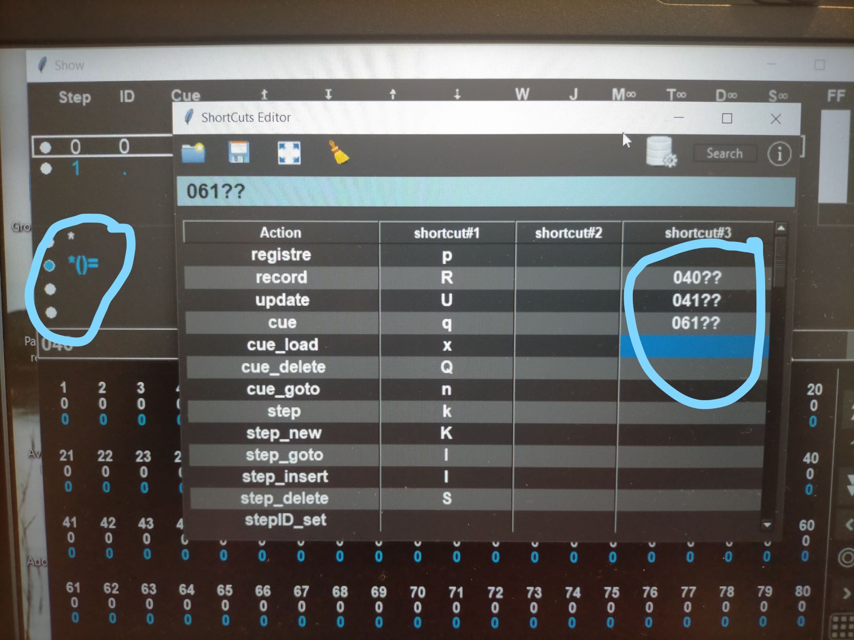

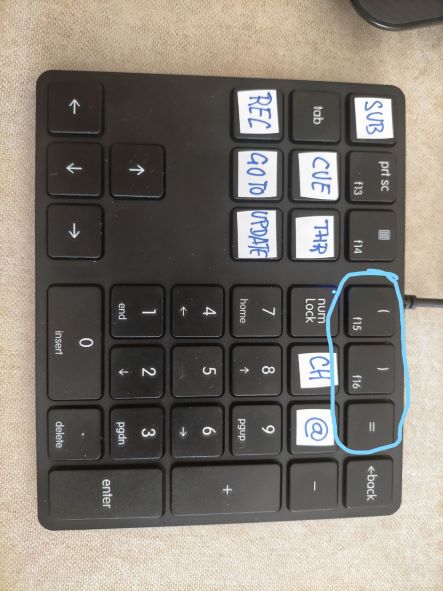

Hello, I'm trying to use an external numpad keboard as a shortcut keypad.(I know there are a osc app. its nice but I prefere push real buttons) and there are several buttons that aren't recognized by
:light (I'm sendig a picture and screenshot to show you what I'm talking about)... Also comen that "Esc" aren't recognizet too in this last version (I've been using a friends computer with V 4.0.0_72) and there "Esc" was assigned as "Kill all subs" by default... Do you know if there are any solution about?

When "(" appear "040" valueWhen ")" 041
when "=" 060
when "=" 060

Good morning. Yes with 4.3.12
Those buttons are recogniced as a text, but not as a shortcut; "Esc" aren't recognizet, too (but I'm supousing that ther are a reason about) ... I'm sanding a picture too

4 years 3 weeks ago #23873
Replied by sl1200mk2 on topic External numpad keyboard
Good morning
that's clear, encoding is failing in the shortcut editor !!
i'll fix that for the next release.
thanks,
thanks,

Yes, on the second picture is what I'm showing. As a text (where you writte the cue name or description) It appear correctcorrectly ( ) =
Is as a shortcut When those caracters are unrecognizet... I tryed on a notepad , Word and txt editor and it "works fine"
