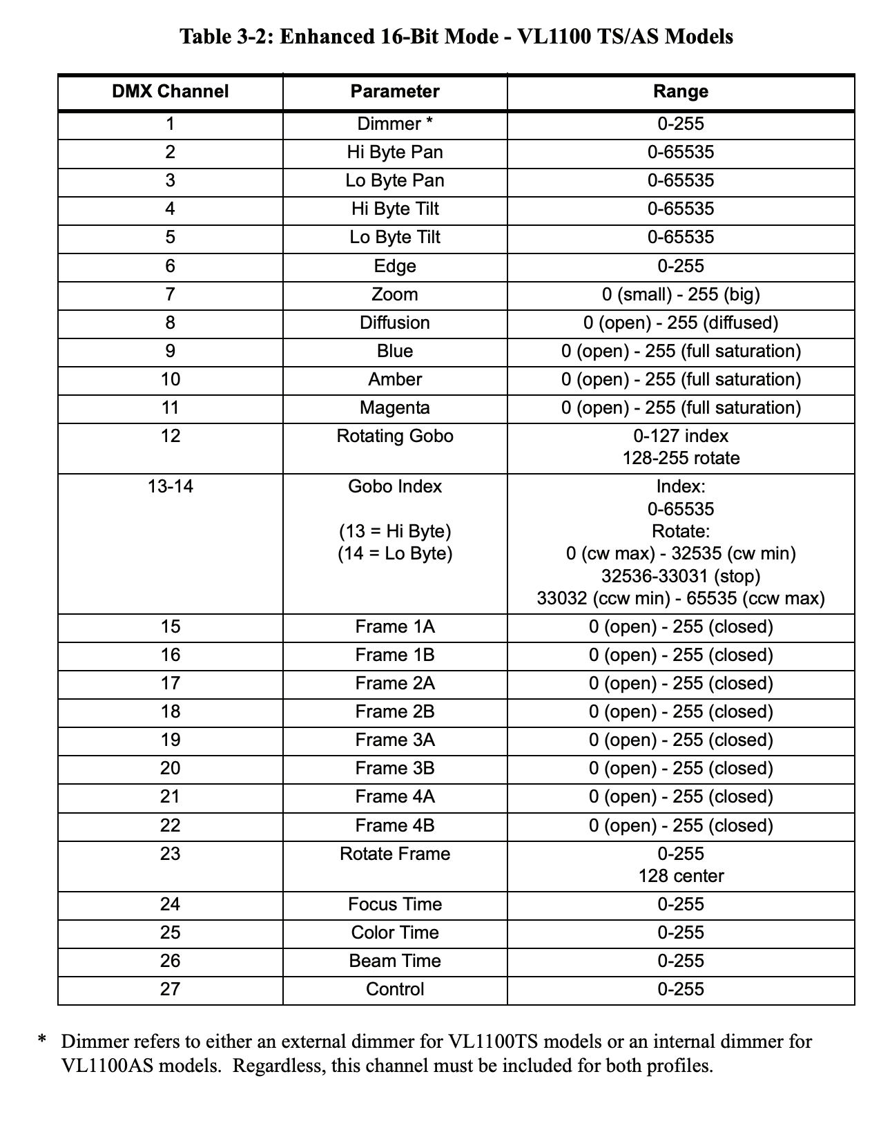

Hi all,
For a new show we are experimenting with a moving head who was available at our venue.
Can anyone help me with a fixture definition file for that specific spot?
I've tried already importing the VL1000 file from the download section on the site, but no luck.
Some weird movements and flickering, I assume that one or more parameters are off...
Also, I've didn't had any luck yet in creating it by myself in the editor of
:Light.
I've joined the DMX-chart in this post in the hope that someone has better luck than me!
I also joined my best shot in creating a definition for the spot.
Any help would be appreciated,
Kind regards,
Bram

Replied by sl1200mk2 on topic Fixture Definition Vari-Lite VL1100TS 16bit (27ch)
so,
it's not easy to work with non RGB nor CMY fixture....
Blue/Amber/Magenta are not common parameters... maybe you should set Cyan/Yellow/Magenta for offset 9, 10 and 11
offset 12 is Gobo (not colorWheel), 13 is rotation and 14 is FINE of 13
except that, your personality should work.
what does not work from your tests?

Replied by SaFaRi187 on topic Fixture Definition Vari-Lite VL1100TS 16bit (27ch)
Again, you saved my day!
Everything works as it should be now.
Thanks again Nicolas!
