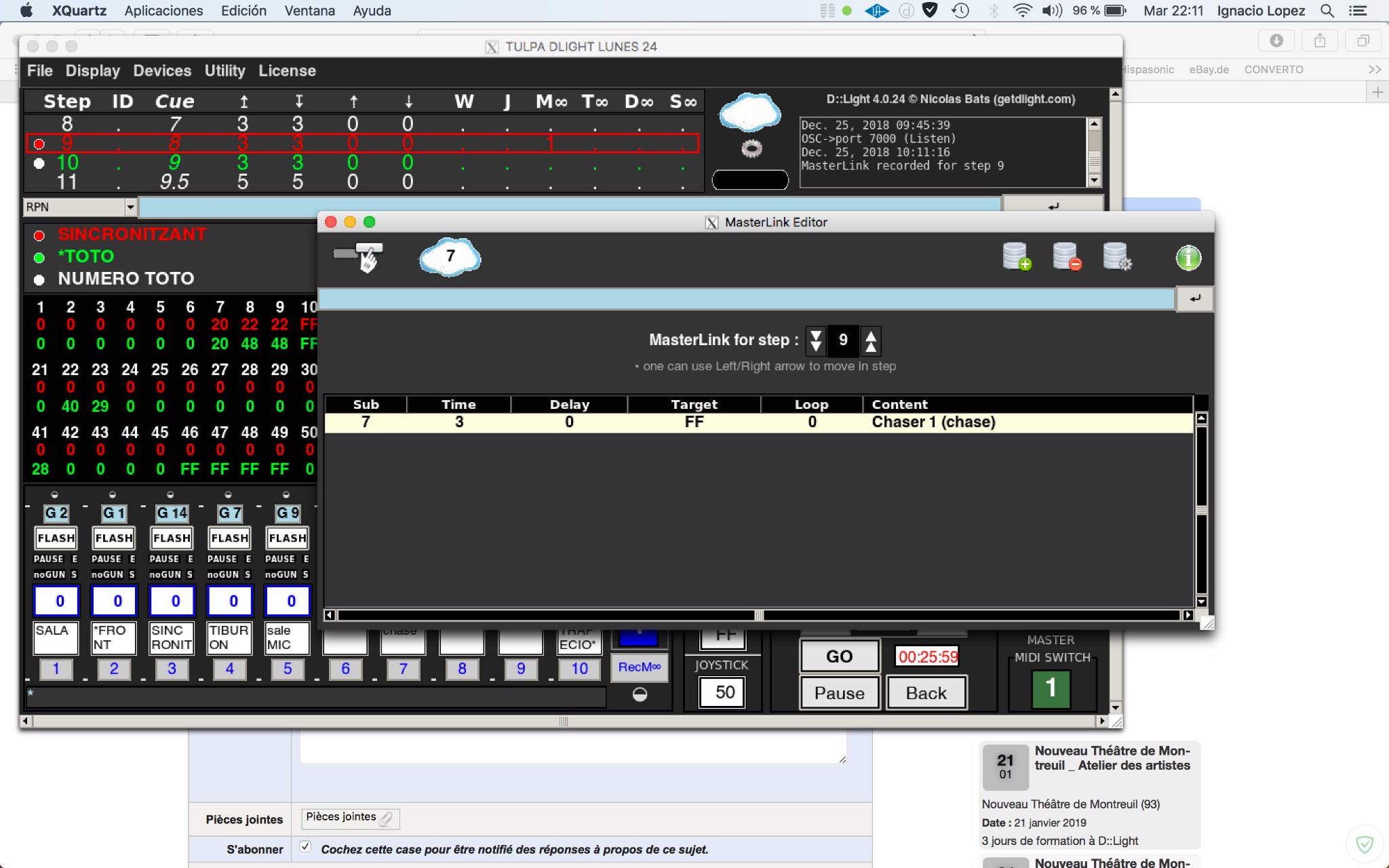

Hola, I need to connect a chase in a scene, i tried Mlink, followed all steps but it's not starting with the step (scene), do i miss something? I followed the steps from the wiki (picture attached) but nothing is connecting with the step

Hi
Mlink only start when you launch GO.
Also you must check they are not inhibed from the setup.

Thanx a lot,, now it starts but it doesn't stop. I can not count how many loops because time is different every day. is it possible to stop it when hit GO to the next scene?

You need to register another MLink with target at 0 at the desired step.

Thank you!!! that helps a lot
