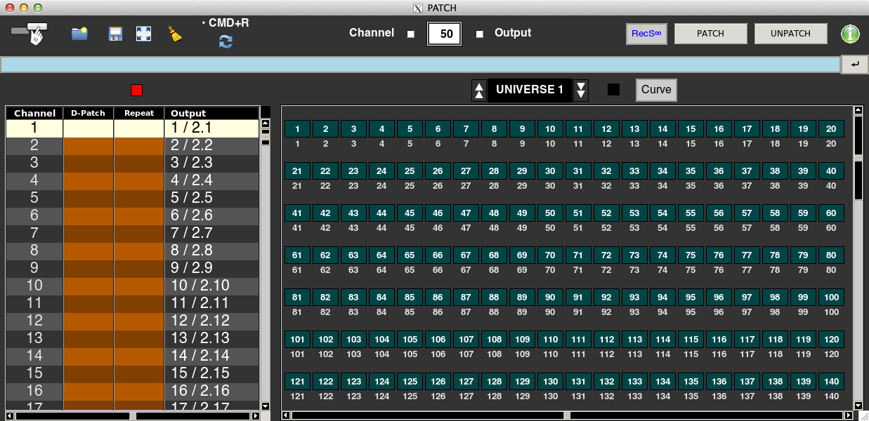

in the patch window I find the universes, for example if I have an artnet interface of 2 dmx universes, I make the patch, but there are only 512 channels, if channel 1 is 100%. It would . channel 1 of universe 1 and channel 1 of universe 2, is that so? or can I control the 2 universes independently?

you'll find attached 2 pictures of patch, one where only one universe is patch, so that channel 1 control output 1 of universe 1 and on the other picture where 2 universe are patch, so that channel 1 control both output 1 of universe 1 AND output 1 of universe 2.

I have that clear, now, in the window of the circuits, if I only want to control channel 1 of universe 2, how I do that, and how I know I am doing that ..how do I call channel 1 of universe 2 ??
if I want to record my show without the interface 2 universes, and when I have the interface 2 universes, I just make the patch. It's what I want to do.

there's no channel 1 of universe 2....
there's output 1 of universe 2 where you can patch channel 1
