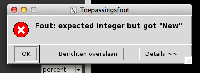

In the setup options I tried to change the font in 'police font and size'. It worked, but when I want to revert backto the original font. It gives an error message (see pic below) and for now I'm unable to change te font. No font seems to work/load...

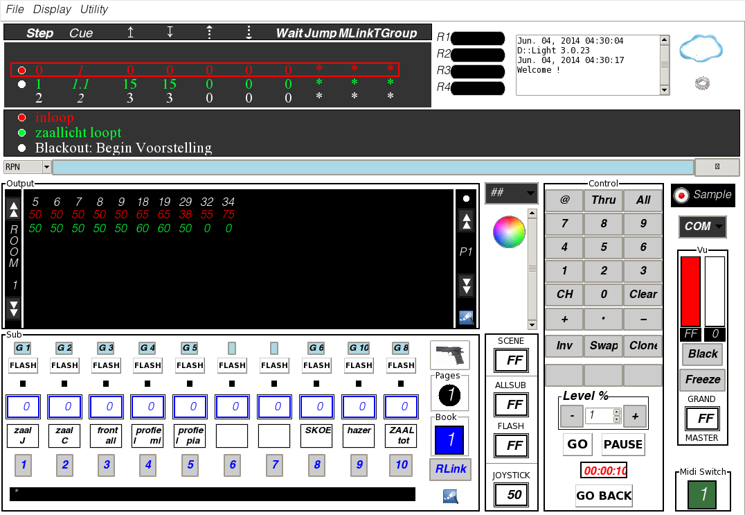

Also strange is that all the text in the main screen is suddenly in italic...

Logfile:
expected integer but got "New"
while executing
"font actual $defaultFont"
(procedure "::ChooseFont::Init" line 9)
invoked from within
"::ChooseFont::Init $defaultFont"
(procedure "::ChooseFont::ChooseFont" line 57)
invoked from within
"::ChooseFont::ChooseFont "$font4seq $font4seqSize""
invoked from within
".setupMod.main.sf.scrolled.ffont.b invoke "
invoked from within
".setupMod.main.sf.scrolled.ffont.b instate !disabled { .setupMod.main.sf.scrolled.ffont.b invoke } "
invoked from within
".setupMod.main.sf.scrolled.ffont.b instate pressed { .setupMod.main.sf.scrolled.ffont.b state !pressed; .setupMod.main.sf.scrolled.ffont.b instate !di..."
(command bound to event)

12 years 4 months ago #8259
by SaFaRi187
Replied by SaFaRi187 on topic Font Problem with DL
Solved! I got back to XQuartz 2.7.5 and now everything is as before!
