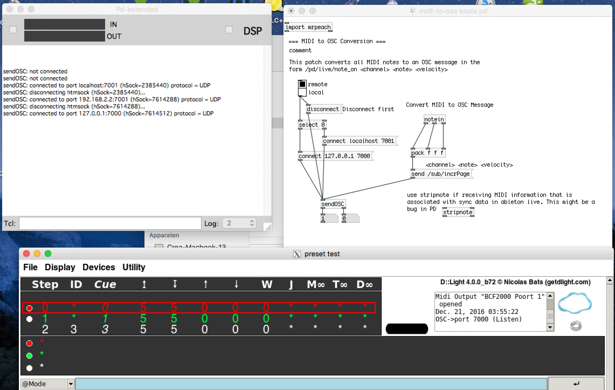

il y a 9 ans 10 mois #13976 par vbs
Réponse de vbs sur le sujet Pure data < OSC > D::Light
Hi,
I am trying to make a file from Pure Data to connect with dlight
Playing a midi note should increse the submaster page.
It is not working and the problem is : the OSC message is not correct or Dlight is not conecting to Pure data.???
Is there someone that can be of help in this ( I am a beginner with PureData?
Added is a screenshot of the connection Pure data and Dlight Ip 192.168.2.2 7001
Pure data file
Thanks Vincent
il y a 9 ans 10 mois #13978 par sl1200mk2
Réponse de sl1200mk2 sur le sujet Pure data < OSC > D::Light
Hi
You need to use the loopback address
127.0.0.1
il y a 9 ans 10 mois #13979 par vbs
Hi
I change the adres to 127.0.0.1 7000 but it don't seem to connect yet.
do i need to setup a virtual network adapter ?? I know you can do this in Windows but i work on a Mac.
Regards Vincent
il y a 9 ans 10 mois #13980 par sl1200mk2
You do not need to create a virtual network.... it should work out of the box.
I don't have my pd patch with me but I remember that I use udpsend object.
