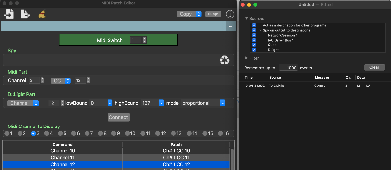

Here is my midi monitor all i/o selected. This is what happens in midi land.
Midi is turned on in dlight, ch3 CC12 is patched to Submaster12, extended midi toggle is off
il y a 1 an 3 semaines #29310 par sl1200mk2
Réponse de sl1200mk2 sur le sujet Submaster not acting on MIDI input
I think I got it.
controlling Midi via other software means that there's could be no reference. this is the purpose of 'bypass level's anchor mechanism' in setUp/Midi
set it to ON and it should be ok
il y a 1 an 3 semaines #29311 par Woodencup
Réponse de Woodencup sur le sujet Submaster not acting on MIDI input
Yes! thank you! Saves me a lot of work!
