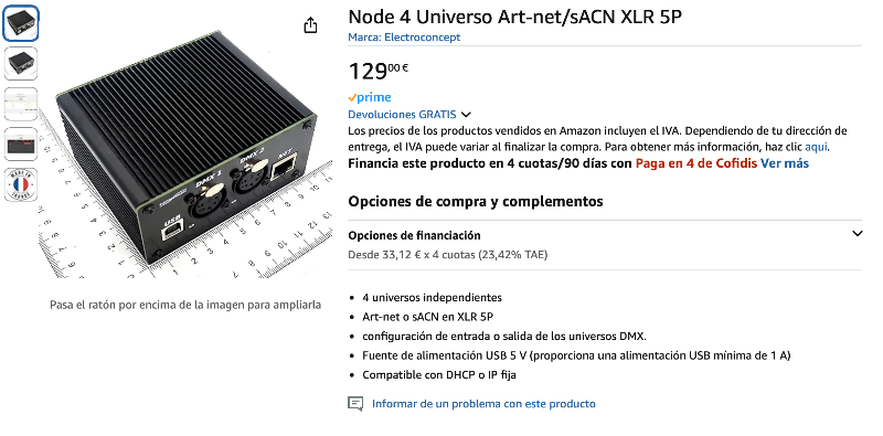

Yes! the home made worked fine and I bought another one another one in amazon (I had to give it back). It's a French company called electroconcept. I send a picture here in case somebody is interested Very good price and it also works fine. I had quite some issues in theaters with the fixed frame rate and the DMX Output rate. Leds were "shaking" in a slow strobe way. I could figure it out, it took me a while.
